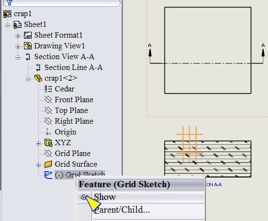

spittle Posted January 12, 2009 Posted January 12, 2009 Here is a work in progress drawing produced in solidworks from a model I'm working on, it's basically a building with some pipes running inside. Most of the model objects are switched off as this drawing is focussing on the concrete slab details. I'm wondering if anyone can give me some tips on ways to improve it. I have drawn a few sketches over the drawing as I felt trying to model them may take longer. I'm happy with most of it but would like to improve: - the grid lines - they're currently drawn on. In my model I have a sketch in plan of the grid lines, and also I have some planes inserted, but I haven't worked out a method for displaying these in a section view. I would like to show a grid line that should be in Section E-E but currently I can only think of drawing it and dimensioning it off the recess cut out for a door. the problem with doing this is if the door moves, the grid line will be in the wrong place. I'm trying to eliminate the need for checking the drawing as far as possible. - the levels - this is my main issue - these are all inserted manually but I'd like to be able to get a bit cleverer and have these update when the model changes. The other entities that are sketched over the top of the drawing rather than modelled are: - The screed (concrete that ensures water drains towards the gullies) - I've not worked out how I'd model something like this yet. -The ground -The dashed line indicating the 1200g Visqueen Damp Prove Membrane (you can see the note). I think this should work ok as I've just offset some of the edges from the model. Any tips would be appreciated, I've attached a zip of the drawing. SlabDetails.zip Quote

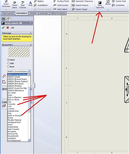

shift1313 Posted January 14, 2009 Posted January 14, 2009 its not really what i do but ill try to help. what do you mean by levels? for your hatch and things. i would draw your ground as a solid and do a section view of your drawing. You can insert the hatch this way and it will be attached to the drawing and not a separate sketch. Quote

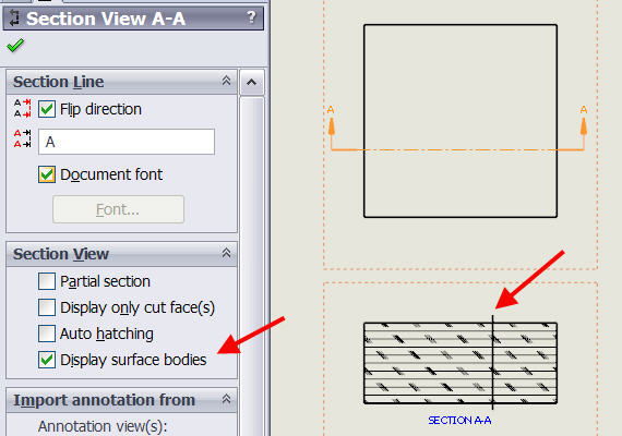

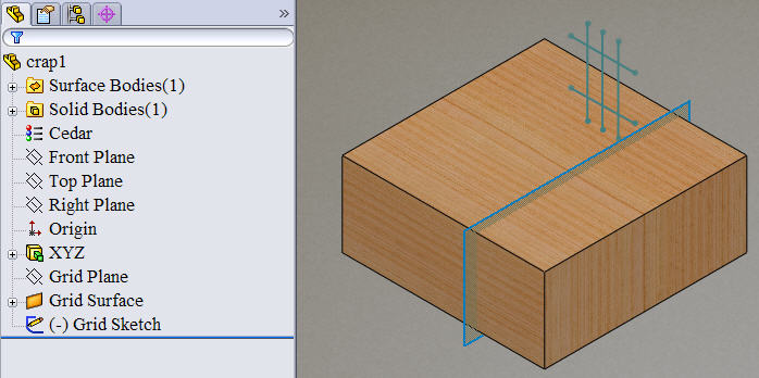

cedar Posted January 14, 2009 Posted January 14, 2009 You can show sketches in section views by RMB “show” the sketch feature. That will show the whole sketch. You can model a surface where you know you will need it in the section. You must check the show surface option in the section properties. Drawing a sketch line in the drawing… making it coincident to the model grid sketch should make it associative. You can define materials with specific section hatch patterns. So if you model the ground… set the material as ground… section will display the hatch pattern defined in materials. Quote

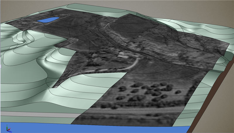

cedar Posted January 14, 2009 Posted January 14, 2009 Like Shift said, import the surface into SW. You don’t have to enclose the surface, you can extrude up to the surface… if it’s completely knitted without gaps. You can model terrain in SW. I did this by tracing an elevation map and lofting between elevations. I cut out my property and applied a jpg to it. I’m sure specialize terrain programs can do a better job faster… but it can be done. And it’s a solid that can be cut or added to a piece at a time. The textured area is 40 acres… modeled full scale. There is a distance limitation, I forget, better check that out if doing something big. Quote
spittle Posted January 14, 2009 Author Posted January 14, 2009 Yeah this stuff is gold, I think I'll try using contours and then loft between them. A further thought - Say you have building consisting of an assembly sunk into your earth. Is there a simple way to cut the area of earth out where the building is? Or would you need to trace around the building and do an extruded cut? Or perhaps a boolean? If I use 3DS Max, I'm able to add my structures, then 'render to texture' an Ambient Occlusion map for my ground surface which comes up black (shadows) where ever my structures are. I can then use this map as a mask to make areas of the surface transparent where structures are. The benefit of this is the building can me moved without having to do any more modelling. I guess I can practice more tomorrow. Quote
