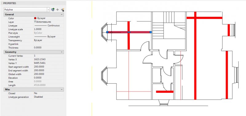

I'm overlaying some disto measures onto a floor plan created by another company to check for accuracy (I am in model space).
I am using the same layer and have not changed any properties yet some lines appear thicker than others per the photo.
Is there any explanation for this?

OK....you mean visually on the screen or when printed?
On screen. I don't see a reference to Z.
If you didn't deliberately set the polyline to a width of 200, it is probaly a left over from someone who used that setting at the other company, change the variable "PLINEWID"=0, it is a variable that is saved with the drawing.
Any wide polylines in the drawing can all be changed back to zero width in the properties pallette.
