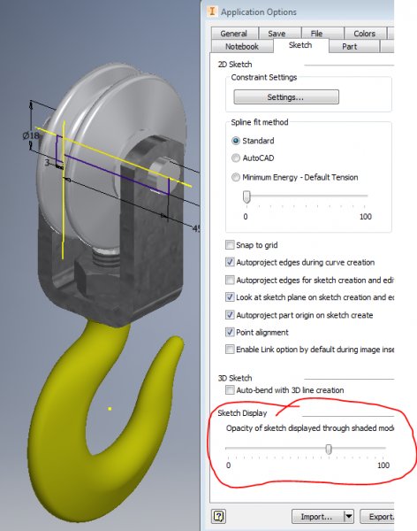

JD Mather Posted February 8, 2017 Posted February 8, 2017 I don't know why anyone would want all (consumed) sketches to stay visible. That would drive me bananas. Having said that, users familiar with SolidWorks will probably appreciate this setting in Inventor 2017 For several releases it has not been necessary to mark a sketch as Shared prior to reusing it for another feature. Any visible sketch that has already been used for a feature is automatically Shared with any attempt to use for a new feature (except in one obscure location/feature which I fail to remember, and I think that was simply an oversight). Quote
