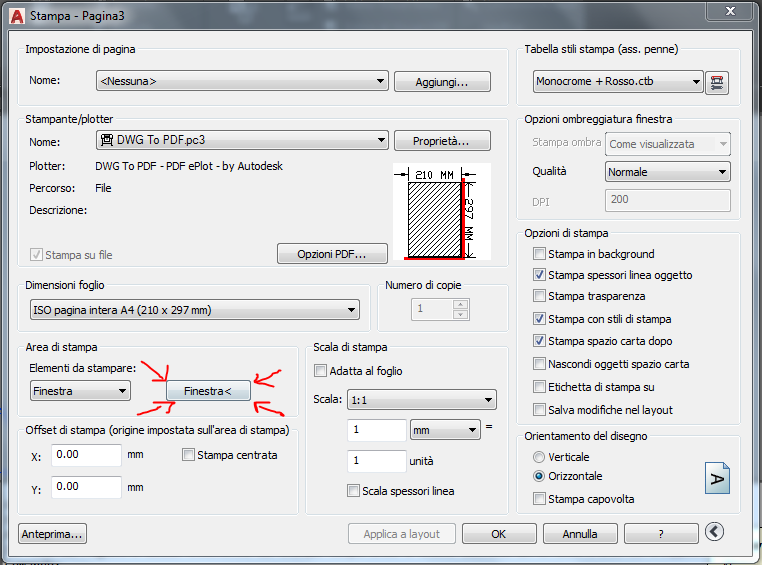

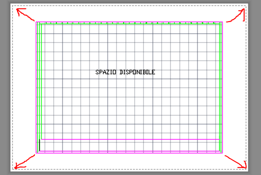

i need help....I am looking for two command of VBA of the layout. Some example would be fantastics...
The two command are:
--> one to increase the dimensions of viewport
-->the another to set the windows to print through the setting of two point (lower left corner e upper right corner of the area that i want to print)

What's wrong with making a template (.DWT file) with all the right settings in them?
Also setting some 'standaard' page setup options can do the trick.
But to be honest i don't really understand the question.
You could write a lisp routine with the following command:
-plot
Most settings that the plot windows has can be done in the commandline.
The lisp command line version
(COMMAND "-PLOT" "Y" "" "[url="file://\\100B-CLR-PRN03"]100B-CLR-PRN03[/url]" "A3 (297 x 420 mm)" "m" "LANDSCAPE" "N" "W" "-6,-6" "807,560"
  "1=2" "C" "y" "DesignlaserCOLOUR.ctb" "Y" "n" "n" "n" "N" "N" "y")
