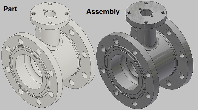

I have a problem. I can see appearance assigned to a part only at the assembly level. It is not shown at the part level. What can be wrong here? I have reasons to believe that the installation/library management was not perfect on our side - could this be the reason? Inventor 2017.

The appearance was not applied at the assembly level. My Inventor displays same appearances differently in part and assembly. I suspect faulty installation and library management. But who knows...
So it was applied at the part but only displays right at the assembly?
Yes, like on a screenshot I provided earlier.

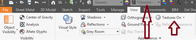

At the part level does the appearance dropdown tab list the material you are expecting to see? If it is, on the VIEW tab do you have Textures on?
Do you also have a material applied other than GENERIC that could override the material appearance?

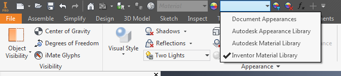

At the Assembly level what is the dropdown for material showing when no parts are selected in the tree? Does it says "Inventor Material Library"?
When you select the part in the model browser what does the appearance dropdown box now say? Is it the same material it says in the part file?
The default location for the materials is not different from parts to assemblies, but the assemblies do have some options for where to look. There is nothing i can think of that would make the assembly view be correct but not the part. If you want to check you can go to File>Options and then to the "FILE" tab inside the application options window. The bottom of that will show "texture folder"
