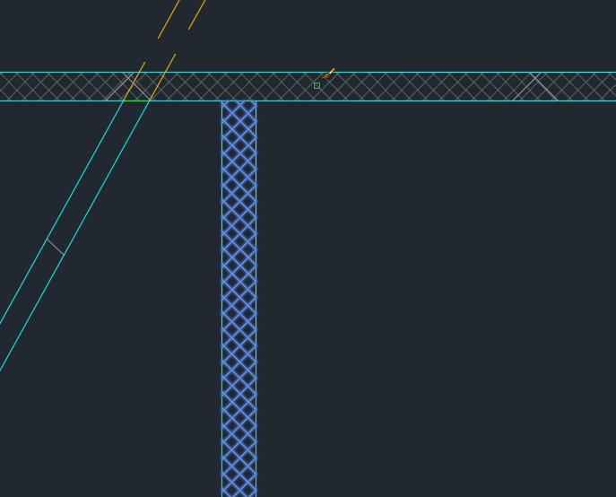

I wasn't try to matchprop an area without hatch.. it was only the result of a previous attempt to matchprop.. the scale gets alterate after the matchprop.

as you can see they all have the same proprieties but they look different.
I have to change the scale from 0.8 to 0.03 in order to make them look the same.

Now I understand what you are describing. I hadn't realized that what you were clicking on was a line in the hatch pattern.
How did you apply the hatch in the first place, that they represent differently? That would seem to be the key to, the behavior being demonstrated, which I have never seen before.
Unfortunately it's not my dwg, I get this drawing from a customer. In the two diagonal walls there was another hatch, I just wanted to uniform them.. but it doesn't work :D
I've uploaded the dwg if you want to look to.. I fixed it by changing it to Ansi37 but that's very strange ... :S
From what I could find it's caused by having the same name of hatch, but one being imperial and the other metric somehow getting into in the same drawing, which if you look at the two hatches in your drawing shows a distance between the hatch lines in one as 0.1 and the other as 2.54 So that sounds plausible. You can get them to match up again by selecting all hatches of that type and in the properties giving them the same scale, but that may need a bit of trial and error to find the correct scale for your drawing, 0.031496 looks perfect. And if you regognise the numbers that is 0.03937*0.8.
Good work steven-g, I was thinking/wondering about that while I was out for dinner, you nailed it! :beer:
If you select those two hatches which are different, and change the scale in their properties from0.8 to 0.03149, it all looks good to me!
If one runs the -dwgunits command on the drawing, the units are mms, and those hatches were obviously created with drawing units set to inches.
