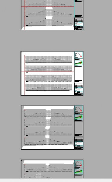

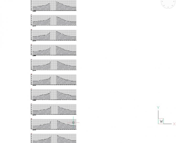

hydrographer Posted February 22, 2017 Posted February 22, 2017 Hi all, I work for a small survey company that provides drawings mostly to engineers. Very repetitive, mostly profiles. Whats the quickest way to fill 10-20 layouts with lots of profiles? This is what i'm doing now but its slow work: Arrange profiles in modelspace: And then copy and paste a lot of chart layouts in paperspace, but tediously shift each viewport adjust keyplan and rename: Maybe a Script could be implemented? ..not quite sure how to go about it Quote
