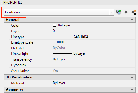

I'm trying to create a lisp routine to run the centerline command then select the line just generated and explode it.
I can get it to create the centerline, and then pick the line
(defun c:clxo  () (command "centerline" pause pause)
(setq sel1 (ssget "l"))
(sssetfirst nil sel1)
but when i add the explode line into it, it doesn't explode.. what am i missing?
(command "explode")
You can not explode a linetype, do you want individual line repeating sequences ? There may be a way with a different command.
A easy way of last object is use (setq sel1 (entlast)) in your case why not "explode" "last" ""
centerline is an object type (as well as linetype.. bit confusing I know). in 2017 theres a default command called 'centerline'
after running it you click one line, click another line and it draws a line central as a 'centerline' . my issue with it is that you are unable to offset this centerline (or do a few other modifications) unless its exploded and turned into a regular line.
thought I could save time by combining it all. ie. run the centerline command, then explode that line. then after its exploded I can run this double offset lisp I've got which offsets a line equally on both sides
Very interesting. You made me open 2017 and use the new command CENTERLINE.
With that being said, I see that the centerline command asks the user to select a first line, then a second line, and places a centerline object between them. A new entity type I was unaware of, and that cannot be offset. Interesting.
Command: CENTERLINE
Select first line:
Select second line:
Command:
Command: LI LIST 1 found
              CENTER LINE  Layer: "0"
                           Space: Model space
                  Color: BYLAYER    Linetype: "CENTER2"
                  Handle = 1010a33
            Associative: Yes
            Start Extension = 0.120000, End Extension = 0.120000
            From point, X= 3576.995446  Y= 1318.941228  Z=0.000000
            To point,   X= 3838.233877  Y= 1057.702796  Z=0.000000
            Length = 369.446933
Command: O OFFSET
Current settings: Erase source=No  Layer=Source  OFFSETGAPTYPE=0
Specify offset distance or [Through/Erase/Layer] <Through>:  Specify second point:
Select object to offset or [Exit/Undo] <Exit>:
Cannot offset that object.
So, I thought I would treat this similar to adding lines to a selection set to generate a polyline afterward, and dug up a snippet from an old code, and it works:
 (setq Center1 (entlast))
 (setq ssCenterline (ssadd))
 (ssadd Center1 ssCenterline)
 (vl-cmdf "_.explode" ssCenterline)
genius! thanks so much. now I just need to work out how to run this double offset command on the line after its been exploded. not to sure how to continue the routine to include below..
