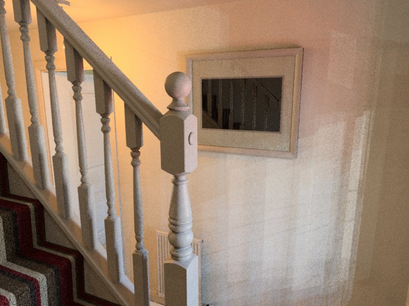

Here's a draft render (low quality freebie) showing a picture frame which is missing its picture:

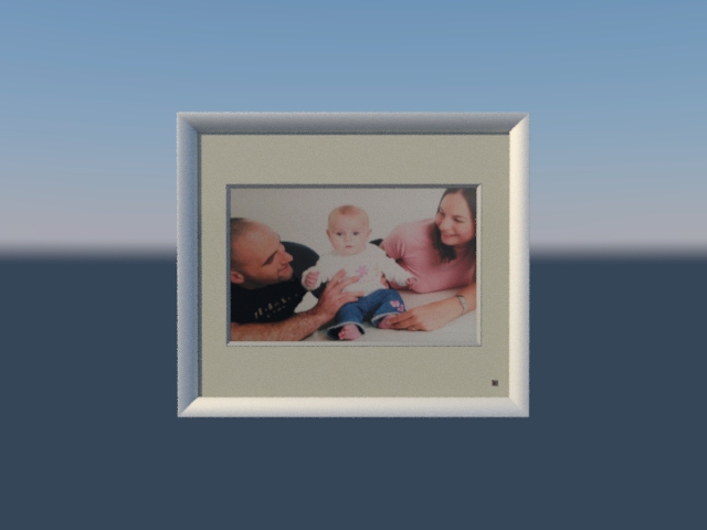

Rendering the objects from within the block is fine:
