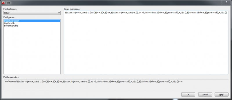

Hi, I think you are asking how to do this
Type FIELD
Set Field category to Other
Select DieselExpression Paste the Code into the window under DieselExpression
