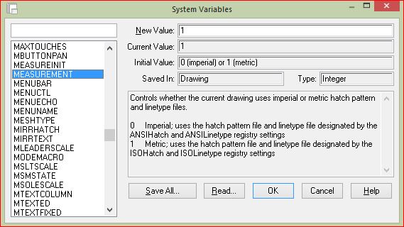

I tried Annotative out with mixed results. Keeping the same Hatch scale for each try, some patterns looked good while some were 10x their normal size (which I don't even know). Why was that? (If the scale had some relation with the drawing units, I could know what they'll look like.)
It sounds like the drawings are in different units, which is why the hatch displays differently in those drawings.
If they were drawn on different unit based templates, the hatch and linetypes will correspond to the base dwg units.
The MEASUREMENT command is the one which determines whether the hatch definitions used are the Imperial or Metric ones, it also sets the Linetypes.

I think that the best way to understand what is going on is to look at the pattern definition files, and is a good chance to see how the definition is made up.
If you open ACAD.PAT in a text editor, the patterns ANSI31 to ANSI38 all have offsets below 1.
If you look at the pattern AR-B816, you see that the offsets are 8.
The patterns have not been defined consistently. The AR- patterns maybe are meant to represent real life dimensions, and the ANSI patterns just fill up the space.
