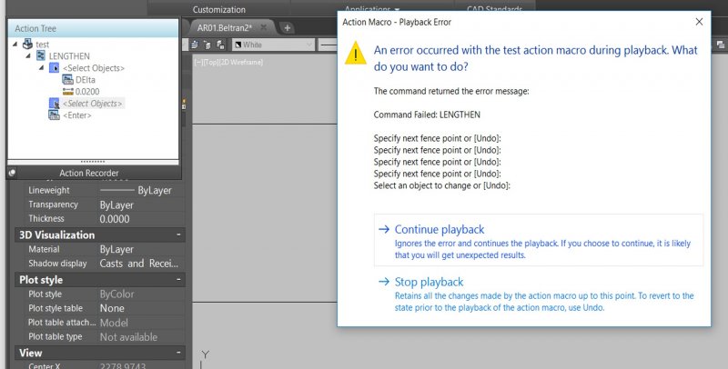

lalcalac Posted March 6, 2017 Author Posted March 6, 2017 Ok, so far by now im getting a lot of useful things with this action recorder, but, i have this problem and i dont know what im doing wrong, im using the command lenghten to do the corner thing, and use the action recorder to automatically set delta and distance, but when the macro stops it sends me this error (image attached), hope can help me with this, thanks b4 Quote
Dadgad Posted March 6, 2017 Posted March 6, 2017 I see that you are defining Delta before selecting the object, which seems to be what you should do. What exactly is the Object type which you want to lengthen? Having just revisited your first post, I see that they are two LINES, which I guess are meeting at their end points, and defining the corner? Wondering if STRETCH might be a better command to use, or SCALE, as the LENGTHEN command only allows you to select a single object. If you used SCALE, and defined the Base Point as the vertex where they intersect, might that work? I often set up my Action Recorder macros, so that I can hit Continue playback without selection, but that would not seem to be an appropriate option here, although you might just try it, to be sure. If you could post a dwg., I would be happy to try it, if I could better understand what the linework looks like. I am wondering if LENGTHEN is the most appropriate command for what you are trying to do, it probably is, but without enough information, it is hard for me to be sure. Quote
