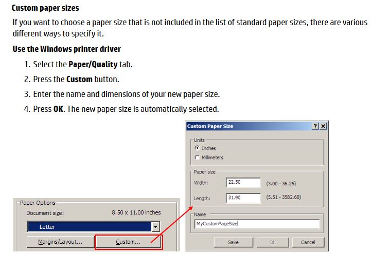

ROBP Posted March 7, 2017 Posted March 7, 2017 Maybe this will work? [ATTACH]60810[/ATTACH] Long time but i think that the R14 version did not have the dialog box to select at that time user had to change it by hand by entering the sizes. Oufff way back omg Quote
ReMark Posted March 7, 2017 Posted March 7, 2017 Where do you see a reference to the R14 plot dialog box? Quote
ROBP Posted March 7, 2017 Posted March 7, 2017 Where do you see a reference to the R14 plot dialog box? Like i have mentionned i do not remember that dialog box or was it with the earlier versions it goes too far back in my memory and do not recall. Quote
ReMark Posted March 7, 2017 Posted March 7, 2017 I'm pretty sure that dialog box may be accessed via Windows > Devices & Printers. Quote
