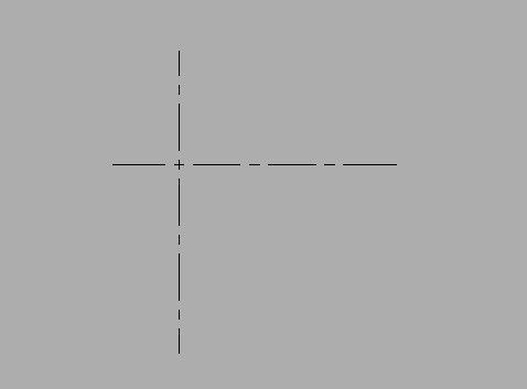

I want to align two perpendicular long dash-small dash lines with their centres in Autocad 2012. I have to do it manually by trial and error. Is there a smart way to do it?

Going down the unconventional route, I modified the Text Explode lisp in Express Tools so that it exploded lines.
The downside is that you now have a number of short and long lines not connected. But the advantage is that now you can get the two short lines to cross as you want.

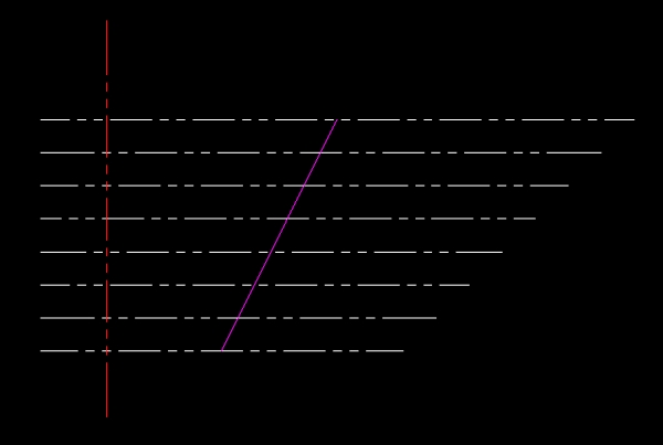

Interesting, Does it honor PLINEGEN ? Can it take LTSCALE or CELTSCALE (48 . 1) into consideration ?
PHANTOMX2 at 0.5 scale
The magenta line connects the midpoint of each line. The red line aligns in various parts to pattern based on overall lengths
Each line increases by 1 unit. The the display length of the first and last segment are determined by autocad. I don't the rules that determines this.
-David

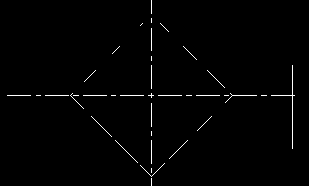

+2, and one can use a rotated pline square (rect) to place the center lines at a particular angle. Circles don't seem to rotate, do they. Draw the center lines to the midpoints of the square rotated to any angle, then draw new plines off those ends along the same angle if they need to be longer.
One of the nice professional looking touches in drafting is always crossing center lines at the center of the short dashes.
You can even make a block of two crossed aligned center lines, and use that as a starter kit. Insert point at the center intersection, of course.
