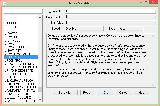

Not sure if I understand what you are looking to do, but if I do, then look at the screenshot.

That can be done with layers but I don't think there is a way to filter the styles.
