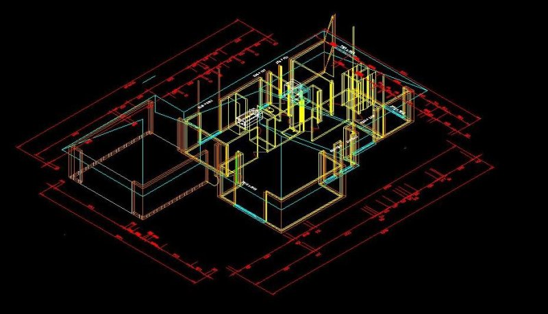

Look at this image it has windows and doors cut into inner and outer skins done the way I described.
