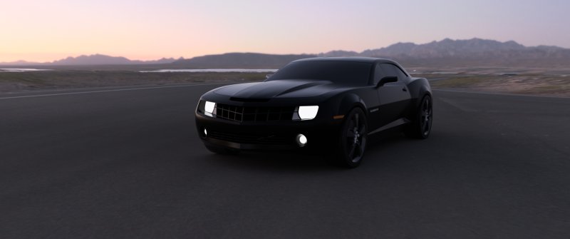

I did the attached render in Fusion360 using an HDR environment so it looks more realistic.
So to break it down. If there is an HDR environment in Inventor you can use for your products go for it. If not, get the angle as close as you can in Inventor to an image you have to use and then slap it in post process. No matter what you do there will be some gamble/variable to it because of lighting, gamma etc. these can be adjusted a bit in PS if you are good at it.
