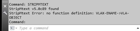

dsibbo Posted March 23, 2017 Posted March 23, 2017 Hi Guys, Can anyone tell me why the STRIPMTEXT lisp no longer works. I've loaded it into my drawing through the APPLOAD command. I've executed the Stripmtext command but once I've select the settings I want and press OK I get this message This is the lisp StripMtext v5-0c.lsp Quote

Tharwat Posted March 23, 2017 Posted March 23, 2017 Copy and paste the following to your command line then run the StripMtext program. Will it work? (vl-load-com) Quote
ReMark Posted March 23, 2017 Posted March 23, 2017 I could run the program without the need for that line. What's the difference between AutoCAD 2014 and 2017 that accounts for that? Quote
Tharwat Posted March 23, 2017 Posted March 23, 2017 No difference but that error comes from Active-X functions when the library of functions hasn't been loaded in prior. vl-load-com Quote
dsibbo Posted March 24, 2017 Author Posted March 24, 2017 I copied the (vl-load-com) into the command line. executed that. (nothing happened) Then I run the Stripmtext command again but I get the same error message. This LISP always worked in earlier versions but with 2017 it hasn't worked. Quote

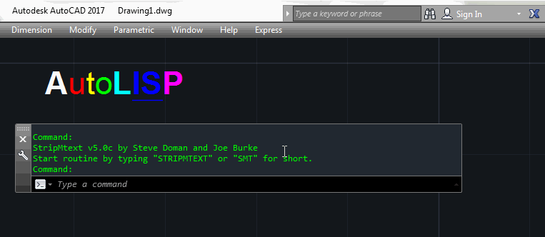

ReMark Posted March 24, 2017 Posted March 24, 2017 Don't blame 2017. That's the version of AutoCAD I tested the lisp routine in yesterday and it worked just fine. Quote
Tharwat Posted March 24, 2017 Posted March 24, 2017 I also agree with Remark is that the program has nothing to fail with in AutoCAD 2017. Confirmation: Quote

tombu Posted March 24, 2017 Posted March 24, 2017 The error shown on your screen means (vl-load-com) has not been loaded. If you ran it before running StripMText then there's a problem with your visual lisp install. You can run basic lisp, but no visual lisp code without it. Sorry, Checked and (vl-load-com) is in StripMText so with a proper install you shouldn't even need to run it separately. Quote

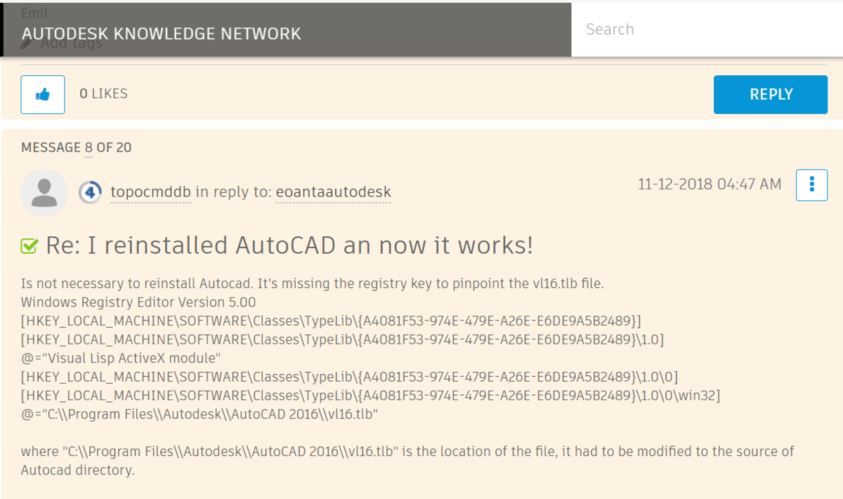

troggarf Posted August 17, 2020 Posted August 17, 2020 I had this issue or something along the lines of this issue at my old employer... I was not able to use any VL or VLA Visual lisp code whenever I had a windows update and/or something was going on with our antivirus program. It would unregister the visual lisp component in my CAD. I entered many requests for support from Autodesk and they said that it was something on my end that was causing this and that the only way to "fix" it was to reinstall CAD. I was able to use pure AutoLISP but no visual lisp code. Are you able to use AutoLISP code yet couldn't use visual lisp programs? I hope that this isn't the case for you... ~Greg Quote
BIGAL Posted August 17, 2020 Posted August 17, 2020 if you google missing (vl-load-com) or similar, load something like appload vl.....arx this loads the VL module the other way is that you Regedit as it has the incorrect detail for loading the Vl arx. Doing the reinstall resets these and normally fixes. Possible fix Quote
