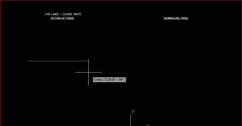

hello i have autocad mech 2013 and today my autosnap tooltips disappeared!!! why ? i checked in options and they are enabled
when i draw a line appeared the distance now i don't see anything

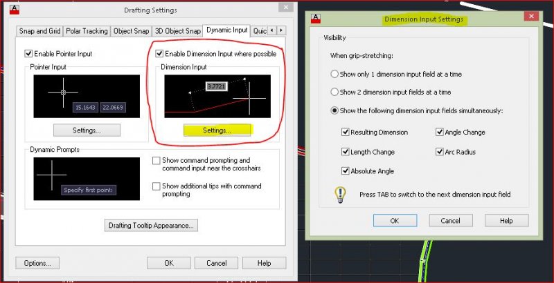

Might you mean DYNAMIC INPUT?
If so, try F12 to turn them back on.

no dynamic input. when i draw a line for example without dynamic input there was a preview box of the lenght of the line
i mean the line lenght display
That sounds like one of the available options in DYNAMIC INPUT. :|
Oh Now i reset settings in autocad and everything is become normal !.
I Mean when draw a Line active orto mode and the dimensioni appear.however thanks .
