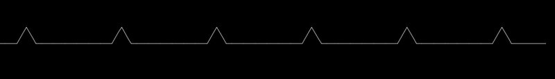

lianli34312 Posted March 24, 2017 Posted March 24, 2017 Hi everyone, What i want to do is draw a retaining wall on the plan, and i want to make it a linestyle, but i failed to do so, instead i have just create a hidden line when i try to use my linestyle:unsure: Anybody can teach me how to do so? Quote
ReMark Posted March 24, 2017 Posted March 24, 2017 It could be done using Express Tools commands Make Shape and Make Linetype. A quick example I just mocked up using the commands. Quote

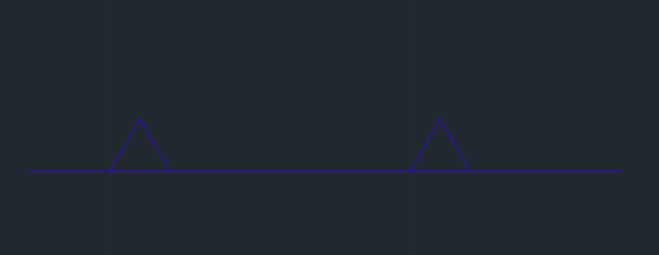

tombu Posted March 26, 2017 Posted March 26, 2017 Hi everyone, What i want to do is draw a retaining wall on the plan, and i want to make it a linestyle, but i failed to do so, instead i have just create a hidden line when i try to use my linestyle:unsure: Anybody can teach me how to do so? I taught an online course on that in 2003, but AutoCAD help covers it pretty well. That triangle will require either a shape or a text style reference. Even though it's a scale we rarely use set a blank drawing at 1:1 while testing linetypes so the units in the definition match close to what's on the screen. Keep in mind AutoCAD adjusts the linetypes to fit the line so draw the line longer than you need and just zoom in to see if the pattern looks like what you want. Home now, but I may already have one like that at work. Quote
ReMark Posted March 26, 2017 Posted March 26, 2017 I created the linetype using the two commands referenced in my first post. The shape consisted of a series of three lines that looked something like this.... ------------^ The long line was one unit in length. The two short lines making up the caret-like shape were .25 units in length. The distance from endpoint to endpoint at the bottom of each of those two lines was also .25 units. I'm not on my CAD computer at the moment. If I get a chance later I will fire it up and attach a copy of the linetype to a subsequent post. Quote

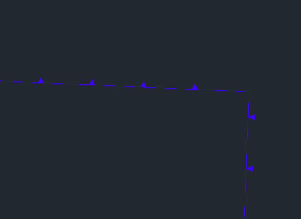

lianli34312 Posted March 26, 2017 Author Posted March 26, 2017 I created the linetype using the two commands referenced in my first post. The shape consisted of a series of three lines that looked something like this.... ------------^ The long line was one unit in length. The two short lines making up the caret-like shape were .25 units in length. The distance from endpoint to endpoint at the bottom of each of those two lines was also .25 units. I'm not on my CAD computer at the moment. If I get a chance later I will fire it up and attach a copy of the linetype to a subsequent post. I think i have did the job:shock:But why my linestyle seems to have some orientation problem.......... I create this by drawing a continuous line with a "^" character on the top created with MTEXT Quote
ReMark Posted March 26, 2017 Posted March 26, 2017 One possibility is the direction that the line was drawn in (counterclockwise vs. clockwise) will sometimes affect the outcome. Quote

tombu Posted March 27, 2017 Posted March 27, 2017 Try adding this Linetype Definition: *Triangle, Triangle__/_\_/_\__/_\_/_\_/_\_/_\__ A,1,[TRACK1,ltypeshp,r=150,s=.09,y=0.079],0.09,[TRACK1,ltypeshp,r=30,s=.09,y=0.079],1 Quote
tombu Posted March 27, 2017 Posted March 27, 2017 Solid version requires Arial Text Style using Arial font: *STriangle, Solid Triangle__/_\_/_\__/_\_/_\_/_\_ A,1,["\U+25BA",Arial,S=0.2,R=90,Y=-.038],1 Quote
