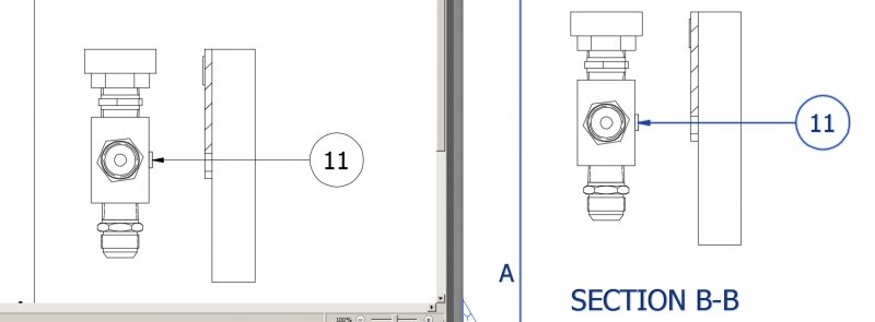

attached is a image of drawing, the blueish items are the ones I can select and explode the part image is just that a image, yet if I insert a block I can get that piece or sheet image.

Yes that was the first thing I tried, along with making sure all the layers were thawed and on. Best I can figure the blocks are in viewports in paper space and I have no idea on how to extract the geometry from them as I can not select them.

The geometry may very well be inserted (attached cross references) images or even pdf documents. Select window EVERYTHING on a layout tab, open PROPerties and check the list of items selected for xref's, or groups, blocks, and other troublemakers.
Activate a viewport and try to select the objects or go to model space and press Ctrl+A to select everything in model space.
