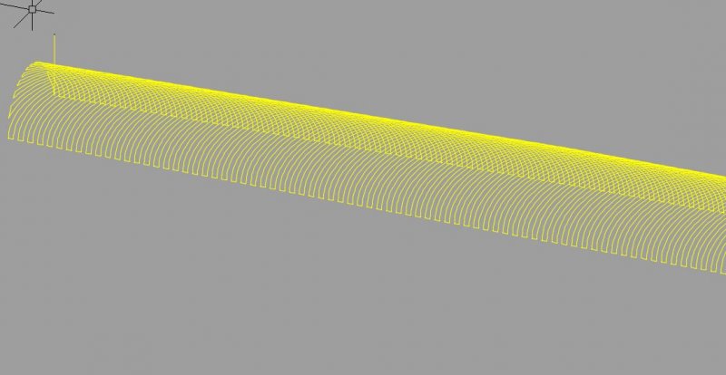

Here are some snapshots in case they're helpful to anyone.

It's the last roughing cycle before the finish pass on a mill. It's leaving .035" of material remaining, so .02 to .025 to be safe. I do need to do the same thing on other polylines that would require tighter tolerances though.
