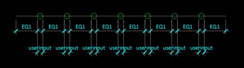

Divide Objects with equal spacing between each object along line or curve
Hi.
I've looked high and low for a program like this.
What I'd like to achieve.
Pick a Line or Curve.
Pick object (mostly squares, rectangles or circles)
Pick distance or enter a width of object selected object.
Program then divides the object on the line or curve like the image attached.
Here's a program I think is close. It's from LeeMac but not sure how to edit it to suit the above needs.

Thanks in advance.

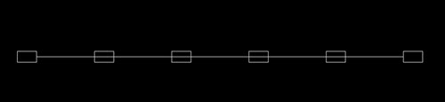

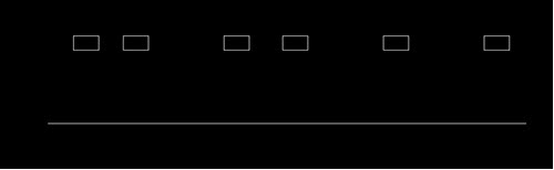

Note that all copies/objects to be spaced should already exist - the program will then position them equidistant from each other.
I see, silly me. See attached the problem. This seems to be a good solution. Quick and easy, just the spacings are a little wacky once I choose the pick the end point.
If this could divide them like the first post it would be a huge time saver.

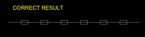

Back to this again. I've found that Routine here & here.
I've modified it so that it asks the user to input or pick the width of the object and then it divides accordingly. Well, it doesn't use the first object and last object in the divide as you can see in the before and after pics attached.
But, I'm glad I could manage to get it to work somehow. Works in UCS too.
If someone could help modify it so that it could use & divide the start and end object along the line then that would be great like the CORRECT RESULT image.
