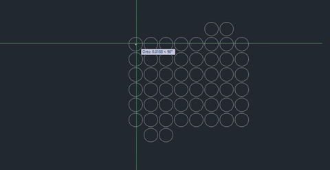

I work for a society that makes voided slabs. Circles represent voids in the slab.
I was looking for a fast way to quote these circles.
Currently I have a lisp that convert poly-lines to quotes.

and this is his behavior:
As you can see I'm interested only about the boundary quotes.
Any idea about how to perform that task without the the polyline? Maybe by selecting all the circles the lisp is able to understand if it's internal or at boundary.
This is an example: Test.dwg
Thanks for the help,
Dennis

On your posted DWG - test, this will work on simple case like in your gif, but on your bigger example in DWG it won't... So, better something than nothing, maybe it'll work on some other simple examples similar to animated gif...

MastroLube
Hello guys! Thank for your help, there is a lot to learn from your code!
I've tested both of them in another DWG (later I'll try to understand each line of the code).
test.dwg
Code from Marko:
works with a little strange error in the left corner.. If you select too much objects (118 in my case) autocad enters in a loop :cry:
Code from Bigal has a strange behaviour..

MastroLube
My posted code should now work with this attached DWG...
Hello Marko! Nice to see you again :)
yup the code as improved, has the little problem of the last point as in the gif I've posted (but only one error and not 2).. Try it on my last dwg... thanks for your help!
EDIT: look at his behavior.. (I've deleted a lot of frames because it takes too long)

MastroLube
Thanks Marko, that helps me very much! :notworthy:
Edited by MastroLube
Share this post
Link to post
BIGAL
Mastrolube I misinterpreted your request as just wanting to know how many holes. So I have removed the code.
Edited by BIGAL
Share this post
Link to post
MastroLube
Sorry Bigal, I didn't get the notification about your reply.. I'm looking for a fix that consider the holes but it's very hard (at least for me). :(
Share this post
Link to post
marko_ribar
I've updated both my codes from this thread...
Regards, M.R.
Share this post
Link to post
MastroLube
Wow thanks marko!! I'll test them right now :)
Thank you very very much
Edit:
Yay! It works :)
Maybe my computer is a little bit old because I've tried to quote the right corner of this 2000 m^2 slab with 10221 circles and after few minutes had to stop the code :(
What's the limit in your opinion?
Thanks again!
Share this post
Link to post
marko_ribar
Look I've changed codes once again...
Don't know for limits, but it is slow if you have many circles... That's simply unavoidable...
P.S. Looking at your picture, you have in some portions of inner holes one row or column of circles - that is not desirable - you have to have at least 2 rows or columns between holes - outer boundary...
Share this post
Link to post
MastroLube
Thanks you Marko! I'll test it tomorrow!
Thanks and good evening :)
Share this post
Link to post
marko_ribar
I've updated codes once again in order to speed things up...
My previous comments stands unchanged... (2 row or 2 columns minimum between)
Share this post
Link to post
MastroLube
Hello Marko!
I admire you so much!! :)
I've tried your code with my huge slab and after 1 hour I've pressed cancel for mistake :(
Anyway I found a good use of it even for big slabs! If i select only external circles it works very well and haven't to wait ages.
For small slabs it's perfect!
I've created a tool in these years and we give it for free in our site.
If you agree I could add your code inside it and add credits to you :)
Your code is the cherry on top. :notworthy:
Share this post
Link to post
