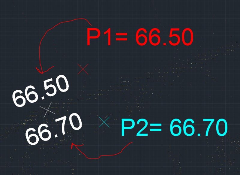

I need to add a lot of spot height in a road pavement an I would like to use a lisp.
In need to add 2 spot value under the kerb line.
The first one (11.11 ex.) in under the kerb the second one (22.22 ex.) is below the kerb.
I built a block with 2 prompt values:
STREET.dwg
Height_1=11.11
Height_2: 22.22
This lisp should work:
1: PICK THE INSERTION POINT.
2: PICK THE FIST VALUE (Height_1)
3: PICK THE SECOND VALUE (Height_2)
Usually i used the follow lisp but it is able to add just one value at time.

Hi @Aftertouch,
this work well but i need to add the value manually. I would like to pick 2 point, get the z value, and use it to fill the attribute values
Thanks
yes, i would like to do this.

i tried the lisp but i get the same height values in two different point with different z value.
Tharwat, thanks for that.
So is that what you wanted or you still in need of any changes?
I would like to add the z value of the first point in Height_1 and the z value of the 2nd point on Height_2. Right now your new version of the lisp copy the first z value on both the place (Height_1 and Height_2).
Thanks
Edited by whosa
(if (= (vla-get-tagstring at) "Height_1")
                              p1
                              p2
That's what the program does and you can have a look at the above part of codes which means if the tag name is equal to "Height_1" then get the Z coordinate of point one ( p1 ) otherwise get Z of ( p2 ).
The tag name is 11.11 and not Height_1 or Height_2
So just change the string in my last posted codes "Height_1" to "11.11"
