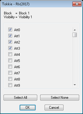

Just a few little lisp tools , dcl , to select one or more strings. Most things can be done with standard lisp and some things not...
A quick explanation :
Smartlist allows to select just 1 text (in this example all the strings beginning with 'tag') ; all the other lines are unselectable and just for comment. Smartlist also adjusts its width automaticly to fit the longest string so the dialog won't be larger than needed.
Tokkie allows you to select strings by toggle and scroll trough the list (slider appears when stringlist has more than 10 strings). Both dialogs are generated by the lisp program itself. Although a standard listbox has basicly the same functionality , the combination with a toggle is just more user friendly (i Think).
More detailed comments can be found in the lisp file.
Have fun.

Impressive work, rlx!
I was wondering before can slider be used this way, to create some kind of "list_box" where the items inside are toggles/buttons.
Gotta spend some time to understand what is happening in your code.
