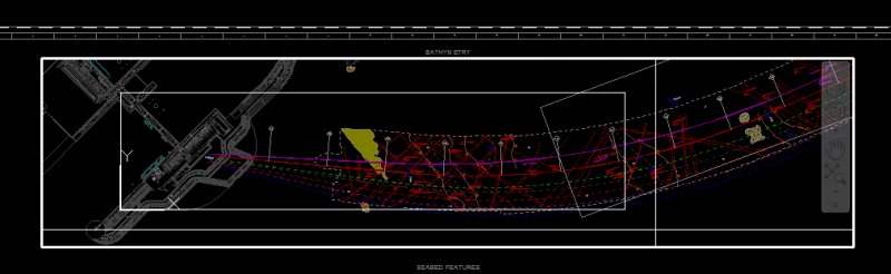

i have to fit the box in the viewport to the box in paper space, as per photo. of course they have the same size.
Inside the viewport, i used zoom/window but no osnap came on... ( of course they are on ) ... what's the catch? why they don't work?

I am not sure of an answer for you, but in this case, after starting the zoom command, use the Object option and pick on your rectangle you have drawn in MS.
Zoom Wndow DOES NOT use snaps. Never has. +1 on the Zoom Object, it is there for just such an operation as you are doing.

Actually Zoom Window will use snaps, you can either set OSNAPCOORD to 0 as mentioned earlier, or type in endp to override the osnapcoord setting.

Seriously? OK, I will check it out. But is it something that I don't want to leave that way? I'll figure it out. Thanks. Maybe its faster than RE Z O. I have to Z W often for dozens of NTS views every day.
No need for Z>W, just Z uses Window automatically. IIRCC, at one time (maybe R14 and earlier) Zoom Window disabled OSNAPS and Zoom left them as they were.
