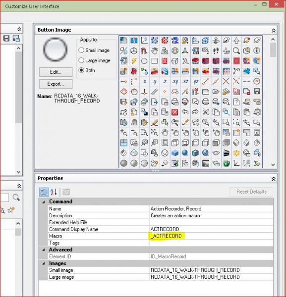

Looking in the cui, I found it at the bottom left under All Commands, and have created a screenshot of the macro associated with the command.
The macro to stop the Action recorder replaces RECORD with STOP.
This does not constitute an informed suggestion that you want to do this, I am merely trying to help, by moving a little information around.
