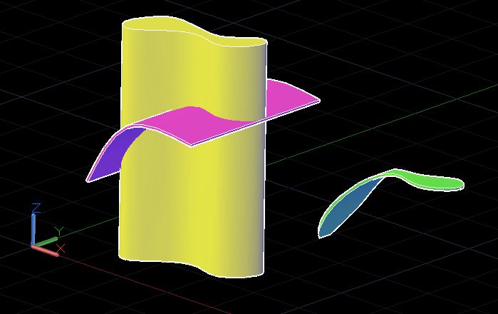

lrm Posted April 20, 2017 Posted April 20, 2017 ]Draw a closed shape for the plan view on the XY plane and a closed shape for the side view on the XZ plane. Make sure the two views are lined up the extrude the two shapes. A Boolean intersect will yield the solid shape. I would post a picture but I can't post pictures anymore since Dropbox disabled their Public share folder. Quote

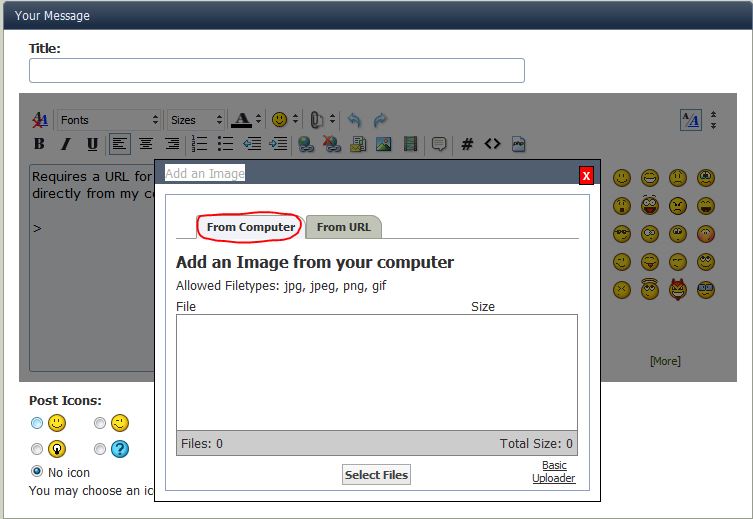

SLW210 Posted April 20, 2017 Posted April 20, 2017 Use the Go Advanced to the bottom right of the reply box then go to Manage Attachments. Quote
ReMark Posted April 20, 2017 Posted April 20, 2017 I usually skip the Insert Image option and click on the paper clip icon for Attachments. One caveat however. After the image you want to attach is uploaded, close the File Upload Manager and click on the paper clip icon to add the image otherwise is shows up twice. I usually use a ">" symbol as a placeholder for attaching the image then delete it. Have a happy. Quote
lrm Posted April 20, 2017 Posted April 20, 2017 I do not see a "from computer" option when I click the Insert Image icon. So, if I got this right, here are the steps to add a picture for a reply. 1. Click Go Advanced. 2. Click Manage Attachments. 3. Click Add Files 4. Click Choose File 5. Navigate to file, select it, click Open. 6. Click Upload. 7. Click Done. Quote
ReMark Posted April 20, 2017 Posted April 20, 2017 Seems almost right. After Upload click on Insert Inline down in the right hand corner of the file upload manager window. Did this using IE as my browser. Quote
lrm Posted April 22, 2017 Posted April 22, 2017 Here's the picture I tried to add earlier. I used the 7 steps I outlined in an earlier post. Seems way too complicated a process to me. Lee Quote
