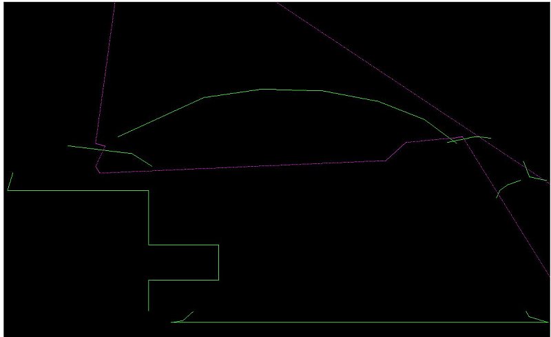

vweavers Posted January 13, 2009 Posted January 13, 2009 Typically, I use polylines to connect my drawings, and make template dxf files (AutoTemp Program). However, I needed to stretch my drawing along one axis, so I (for the first time) used BLOCK. Stretched, exploded, and made my changes, saved dxf, and looked ok, however, when the AutoTemp program loaded the file, for some reason, several of the "pieces" are skewed and out of place. The only thing I've done different is used the BLOCK command this time. Am I missing something along the way? PS- and for some reason, I can't turn most of my pieces into polylines?! Quote

vweavers Posted January 13, 2009 Author Posted January 13, 2009 Just made a discovery- I mentioned in my 1st post that some pieces were skewed. What I did was stretch a block, explode, mirror the image to duplicate, and save to dxf. The MIRRORED image is the one with pieces skewed in the AutoTemp program. Quote

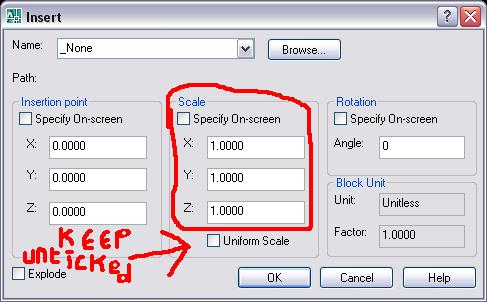

skipsophrenic Posted January 13, 2009 Posted January 13, 2009 Have you tried WBLOCK an then Re-inserting setting your own x - y scales? Quote

vweavers Posted January 13, 2009 Author Posted January 13, 2009 Tried WBLOCK. Didn't do anything for me. Problems still are: 1) after making object into a BLOCK, STRETCHing, EXPLODing, then MIRRORing: the MIRRORed portion of the drawing has several arcs, etc that are skewed, and out of place, when loaded into my AutoTemp program as a .dxf file. No problems with non-blocked objects being mirrored. 2) after STRETCHing as above, attempting to make arcs, etc into polylines. Straight lines work ok. Thanks in advance for any further help! Quote

vweavers Posted January 13, 2009 Author Posted January 13, 2009 Attached is a jpg of what the skewed pieces look like in AutoTemp (.dxf format) This .dxf looks fine in AutoCad. I can take the same profile, as long as it isn't a BLOCK at some point, and it works fine. Quote
