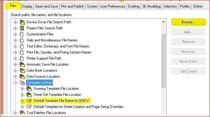

Dadgad Posted April 28, 2017 Posted April 28, 2017 Welcome to CADTutor Cincy. Probably worth adding, you will need to be sure that the template with which you will be working is in the appropriate units of measurement. Most of the standard Autocad templates are Imperial, unless they end with ISO, for metric. Any drawing can be SAVED AS a .dwt file, which as a coder, you likely already understand. Once you have created the template which you think fills the bill, you can set it in your OPTIONS. Click on the FILES tab, then you will find the TEMPLATE settings, where you can BROWSE to, and set the appropriate template as your DEFAULT QNEW template. Once you have designated it as your default, whenever you open the program, that will be the template opened, or when you use the QNEW command. It is quite likely that you may wind up with multiple customized .dwts, for different tasks, units of measurement, or whatever. Quote

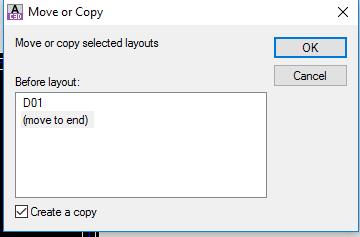

BIGAL Posted April 29, 2017 Posted April 29, 2017 a block actually kind on a mini drawing YES it can live inside your dwg or you can have each block as a seperate dwg which is commonly known as a block library and there are many ways to call up these library items. Re title block you can xref or we have it as a block in our template and has attributes like project name, sheet No, drafter, date and so on ours has around 20 values that you can enter. Copying the layout copies the Titleblock then we edit some of the attributes like, sheet description. You may want to look at sheet sets this can automate a number of tasks in your title block like sheet number. Blocks can have lots of detail including Attributes which you can change the value like I/O number. Whilst Autocad can access sql database, MS Access, the best and for most help code wise is to use excel, or even simpler text data files, including CSV files. Ask here for help plenty will assist. Once you get something together post it here and you will get productive comments back. Quote

nukecad Posted April 29, 2017 Posted April 29, 2017 There are many different ways of working with Autocad, ask 12 Autocad users and you'll probably get 12 different answers. I have always had a border block, with attributes for drawing number, issue,title, etc., in the papersapace of my templates. Along with other saved definitions for layers, dimensions ,etc, etc. set up). That way each drawing has its own drawing border. PS. A paperspace is also known as a 'Layout' which is what is says on a new layout tab. More about this later. You can do it the other way and x-ref in a border, that way if you change the border it changes in every drawing it gets xrefed into. (I never liked that method, because it means a drawing can change in appearence without any revision letter). So from what you describe you seem to have a template with a border block in paperspace, this has a 'Viewport' through into modelspace. You draw elements in modelspace and they show in the viewport in paperspace. You can have more than one viewport in your paperspace, showing different parts of the modelspace, maybe at different scales (for enlarged details, etc.). You can have more than one paperspace (layout), as you have found, by clicking the '+' and opening a new layout tab. This means that you can have different paperspaces, with different borders in each, showing different parts of the geometry from modelspace, all saved as one file. (So you can have a whole project of many drawings all saved as one file). When you come to plot your drawing(s) you plot from paperspace at 1:1 scale, which makes plotting much easier. Then it gets to questions like- where should you dimension things? Some dimension in modelspace, some dimension in paperspace. It all depends on just what kind of drawing you are producing, how you organise your workflow, and what works best for you. (Some still insert a drawing border into modelspace, enlarging it as necessary, it's the old way of using CAD but it's not considered the best practice nowadays) As I say, everyone has their own way of using Autocad. Because it is so flexible it does not dictate any 'best' or 'correct' way to do things, it lets you work in the way that is best for you and your business. This does mean it can be a bit confusing to get to grips with at first though. PS. If you would like to see the sort of drawing templates that I use the you can find a set here: http://www.cadtutor.net/forum/showthread.php?99585-titleblock&p=677649&viewfull=1#post677649 From what you describe in your previous post the one that you have made is similar to these. Quote
