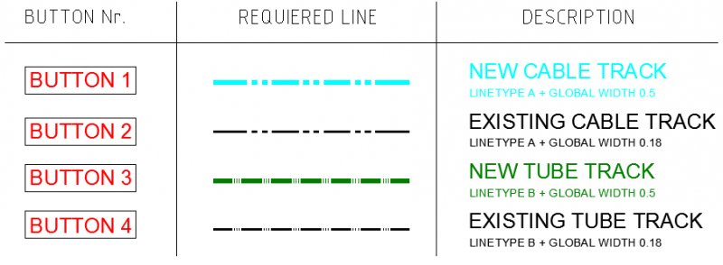

I would like to know if it is possible to write macros (buttons) that can draw polylines within a certain layer, linetype, global width, color.
Thus, as you can see in the image, if i want to draw an existing cable track, the macro should be some sort as this:
go to layer "existing_cable_layer"; draw polyline; global width = 0.18; linetype = A; color = black;
- Before this i tried to set a global width on a layer, but this seems to be impossible.
i just started a couple a days ago with macro writing so i'm quite a beginner.
What i would like the most is that i can make buttons for each cable / tube track.
Thanks in advance!

There are a bunch of different ways you could do this.
One easy way, would be by creating a small block of each one of these, with the WBLOCK command, and putting them all on a custom TOOL PALETTE.
It sounds to me like you are, or should be working on a custom .dwt (template), which includes these layer names, linetypes and properties.
Set the lineweights, linetypes and colors in the layer manager.
Yes, these could also become new toolbar buttons, or custom commands, with macros, which would basically just need to set the correct current layer, and start a polyline.
The custom command aliases might be nct, ect, ntt & ett, for instance.
When in comes to line width doesn't the word "global" imply for the entire drawing? Wouldn't it be better to assign a line weight to each layer?

Hey man,
Thanks for welcoming!
Yes, typical, not long after this post, i found out how to make tool palettes. What a freedom when able to work with those.
Still looking forward to create macros though, you will be hearing from me in the future ;).
Thanks again!

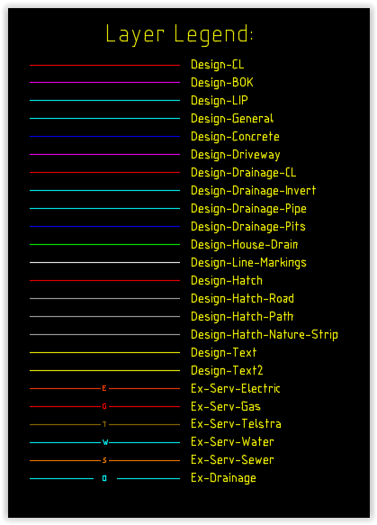

Our version of your request we just have this in our template in the 1st layout and copy and paste close to the area we are working in and just use the "layer select" from the layers toolbar. Very simple.
Here is an example of creation.
You can change for yourself.
