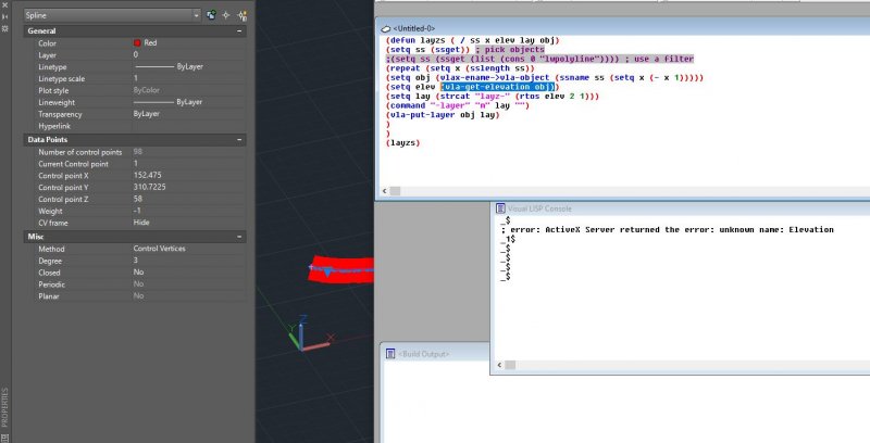

im trying to get my head around how this works and im sneaking in on it
for some reason i get this error and i cant figure out why. i tried changing "vla-get-elevation" to "vla-get-controlpoints" this gives me an error in (rtos elev 2 1)
; error: bad argument type: numberp: #

well im guessing its because theres no "Elevation" in a spline and i cant seem to find a "vla-get-control point z"
but maybe theres another way

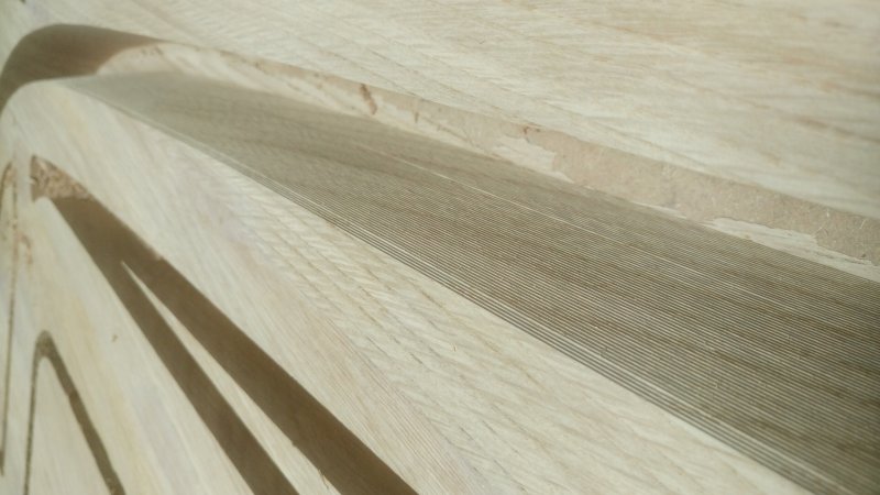

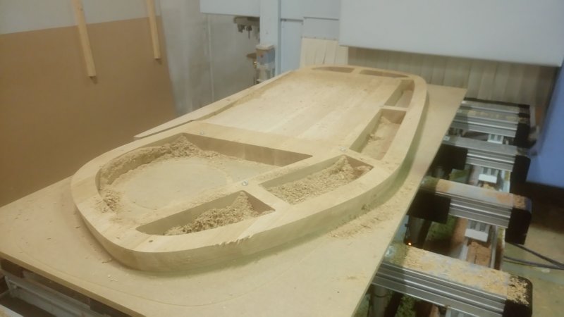

as promised som pics of the product almost finished
nice to see the actual lines in the wood axactly as the cad model.

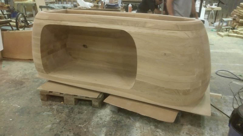

second pictures shows a piece that was routed from programmed from both sides and flipped in the cnc. actually most of the pieces had to be flipped cause of the hole sloping the other way
total weight 400kgs of nice oak in finished product
That's really impressive! Thanks for posting the pics. I think I can smell fresh cut sawdust...
