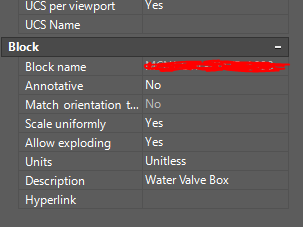

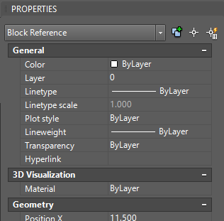

I have created this lisp and it works great but I need help with one thing. This will pull the hyperlinks from blocks and export them to a txt file in the order you select the blocks.
Here is the problem I have. Apparently there are two ways to add hyperlinks to a block. You can go through the block editor and add it there in the properties pane (Image 1 ) or you can add it to outside of the block. (Image 2) Hope that makes sense.
The routine below will work if the hyperlink is on the outside, and of course all the blocks I have, have the hyperlink on the inside.
How do I modify this to extract the "nested" hyperlink?

Image 1
Image 2

Thank you so much. Your routine is great. But it still only pulls the outer hyperlink. Not the one nested in the block... any ideas? I can't seem to find anything on this.
Thanks for all your help!!!
It works fine in my testing - please upload a sample drawing.
Sure no problem, attached.
I think I narrowed down where the problem lies...
While creating the sample drawing I found that your routine worked, nested or on the outside. So I started looking into what was different. My blocks contain dynamic capabilities. As soon as I added some dynamic capabilities. Your routine no longer worked on nested hyperlinks.
I believe this is tied to something I learned recently about dynamic blocks, the block name and the block true name. *U69 vs. HYPIN. Just guessing though.
