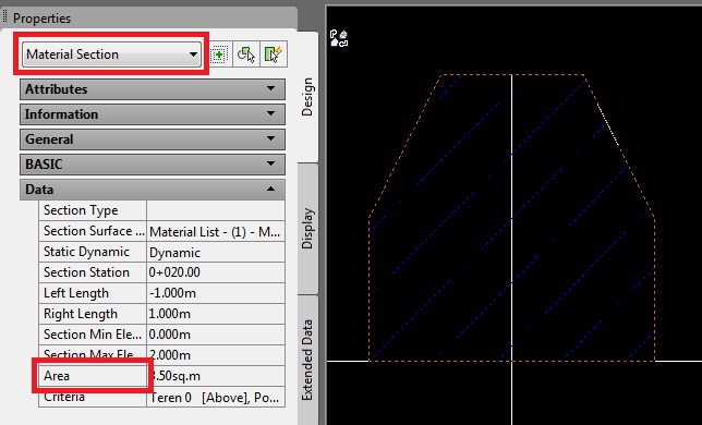

I am looking for the properties using:
(defun c:prop (/ p1 p2)
 (vl-load-com)
 (setq p1 (vlax-ename->vla-object (car (entsel))))
 (setq p2 (vlax-get-property p1 "Parent"))
 (vlax-dump-object p2 'T)
I can not find this property (area).
The property is displayed in the window.
This is shown in the image.
Some things like Area are calculated it may be using the vertices to work out the area. Does it have "Coordinates" in dump?
I can not find information about the area or coordinates.

This is a basic property, why it is so hidden.
Area can not be read from the Material Section
