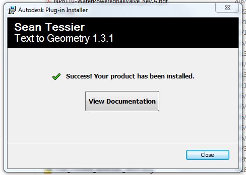

ReMark Posted May 25, 2017 Posted May 25, 2017 (edited) First start by clicking on the .msi file (Windows Installer Package) you downloaded. Did you do that? If not then do so now. When the program is finally installed you will see the following message on your screen. Now all you have to do is click on the View Documentation button and read it. The answer you seek is right at the top of the page. Easy peasy. How do I know all this? Simple. I just installed the program myself. Edited May 25, 2017 by ReMark Quote

ReMark Posted May 25, 2017 Posted May 25, 2017 My file was dated 3/13/2013 and was definitely a .msi file. So, you got the program to work? Quote
