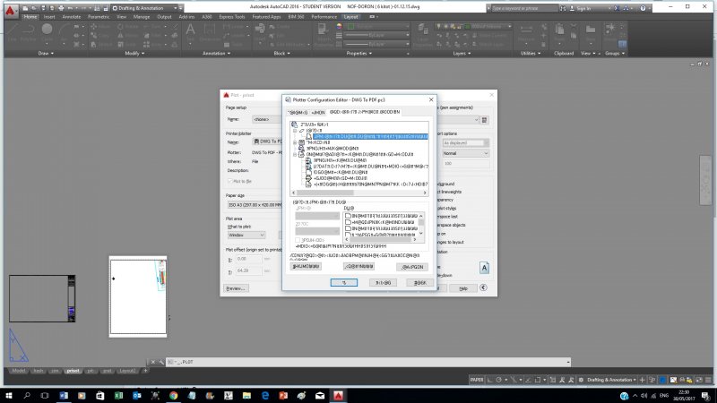

HI All,
I am using AutoCAD 2016 on windows 10. When entering to Plotter Configuration Editor, the text is not displayed in English and I can't use it (attached screenshot)
Tried to reinstall the AutoCAD but still occurs.
It worked in the past and suddenly was changed
Please advise

It was OK in the past on this Desktop too. it suddenly changed.
The problem of the fonts is also when I enter in Command line OPTIONS -> display tab and then trying to change fonts then I can see it in English
