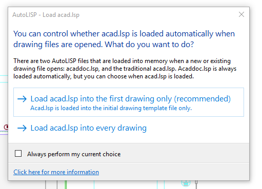

How can I supprsess this message on new machines?
I set ACADLISPASDOC to 0 in the initial startup. How do I suppress this message? or do I have to instruct on what to select?
yeah, i saw those. This isn't a security warning. Just asking if you want acad.lsp loaded every drawing or just on initial drawing. It's going to load at least once either way.
If I set ACADLSPASDOC to zero then why is it asking me again after?
Why not accept the default as shown (top option with box around it) then click on "Always perform my current choice"? Shouldn't that kill the message once and for all?
Note that "ACADLSPASDOC is ignored in SDI (single document interface) mode."
