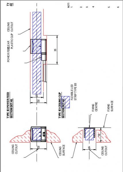

kippax Posted June 2, 2017 Posted June 2, 2017 This is despite its appearance in the drawing. The text is in paper space. Quote

maratovich Posted June 2, 2017 Posted June 2, 2017 Your paper is vertical, and in the print settings you have specified a horizontal one. You have auto-rotated text from the direction of paper. Maybe this will help http://wishsoftware.blogspot.ru/2012/02/making-blocks-text-and-hatches-match.html Quote

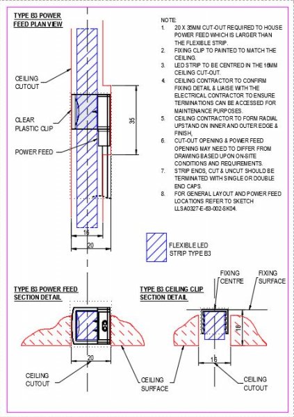

kippax Posted June 6, 2017 Author Posted June 6, 2017 Hi ! Sorry for the delay in response. Yes the paper is vertical, but if you look at the print preview it clearly shows that the orientation is portrait with the text aligned accordingly. I have attached the file for anybody that might be in the position to spare me a little time. Many thanks in advance.... LLSA0327 E 63 002 SK05 LINEARLight Flex Detail.dwg Quote
ReMark Posted June 6, 2017 Posted June 6, 2017 I had no problem when I printed your drawing to a PDF file. However, I did change the paper size to read ISO full bleed A3 (297.00 x 420.00 MM). Simple. Quote
maratovich Posted June 6, 2017 Posted June 6, 2017 Do not you believe us? Why? Here is your file, fixed. LLSA0327 V.dwg LLSA0327 E 63 002 SK05 LINEARLight Flex Detail-A3 V.pdf Quote
ReMark Posted June 6, 2017 Posted June 6, 2017 Always a good idea to check the paper size dimensions when printing to a rectangular format. Quote
kippax Posted June 6, 2017 Author Posted June 6, 2017 Cheers people, as you have spotted it's some kind of clash in the "paper orientation". It appears it's not necessarily enough to simply select portrait/landscape. You also have to select the correct orientation in the paper size. All sorted Quote
