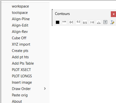

BIGAL Posted February 10 Posted February 10 If you have lots of lisps then why not have a custom menu. For Civ3D I made a custom menu that had CIV3D commands in it so when working in Drafting workspace those Civ3D commands were available. I also made a custom tool bar, it replaced the change surfaces via the Tool space as the icons were say display 0.5 Contours, turn off surface displays etc. Yes its available just ask. Quote
