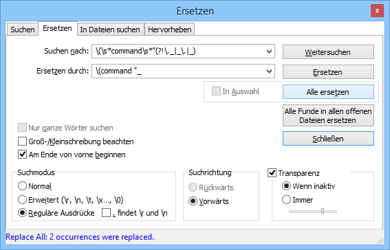

Roy_043 Posted June 9, 2017 Posted June 9, 2017 (edited) @martinle: In Notepad++ you can use regular expressions to search and replace texts. > Notepad++ > Replace... > Find what: [b]\(\s*command\s*"(?!\._|_\.|_)[/b] > Replace with: [b]\(command "_[/b] > [ ] Match case > [[b]v[/b]] Wrap around > Search mode > [[b]*[/b]] Regular expression Edited June 9, 2017 by Roy_043 Quote

martinle Posted June 9, 2017 Author Posted June 9, 2017 Hello roy, I use notepad ++, but it is rather tedious to change everything individually Martin Quote

Roy_043 Posted June 10, 2017 Posted June 10, 2017 @martinle: Using the regular expressions in my previous post *ALL* commands will be fixed at once. Just try it. @BIGAL: It is not a simple case of exchanging one character. Command names may already have a "_" or "_." or "._" prefix. See the 'Find what:' regular expression. Quote
martinle Posted June 10, 2017 Author Posted June 10, 2017 Hello roy, I will try it when I am on Monday again at work. But I can not yet understand their explanation. Excuse me. Martin Quote
Roy_043 Posted June 10, 2017 Posted June 10, 2017 Note that my suggestion will only change command names not command options. So: (Command "copy" unit1 "" "m" p2 p6 p22 p23 "") Will become: (command "_copy" unit1 "" "m" p2 p6 p22 p23 "") Quote

Roy_043 Posted June 11, 2017 Posted June 11, 2017 @Lee: you are right. Thanks. Improved version: Find what (Suchen nach): \(\s*command\s*"(?!\._|_|") Replace with (Ersetzen durch): \(command "_ Alternative (also works for command options): Find what (Suchen nach): "(?!\._|_|\s|\)|") Replace with (Ersetzen durch): "_ Note: Since this regular expression matches not just command names and options, replace matches one at a time. Quote
Lee Mac Posted June 11, 2017 Posted June 11, 2017 Nice one Roy The following could be used to also account for the use of vl-cmdf: Find: \(\s*(command|vl\-cmdf)\s*"(?!\._|_\.|_|") Replace: \($1 "_ Quote

martinle Posted June 12, 2017 Author Posted June 12, 2017 Hello, have it tested and it makes me a lot of work. Many thanks. It works wonderfully! Martin Quote
