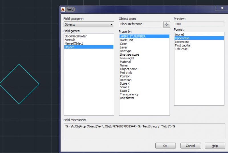

Hi guys its me again, I am trying to create a tagging system linking the attribute to a text field, I have this routine from @Tharwat that creates a text+field after clicking on the target block w/ attribute (it does work with default ent. properties like Block Unit, Color, Layer, Name etc.) but my problem is the attribute def. it has a different ObjectId and since the routine that Tharwat create uses (car (entsel) it will only return the block ObjectId and not the Attribute ObjID inside.
Attribute ObjId 8796087888544
Others ObjId 8796087888528
Any Idea, is this feasible?

Hi,
Replace the function entsel with nentsel and pick on the attribute itself when you are asked to select a Block.
its working now with a big BUT :) , so the attribute need to be visible right?
thank you Tharwat

Sure it supposed to be visible since the user input function asks you to pick an object that is available / seen on the screen.
If the attribute is not visible you can get at the attribute via its creation order but that would rely on you knowing what number when created.
Or use a "." for the attribute value its almost invisible, and then use Tharwat's method.
