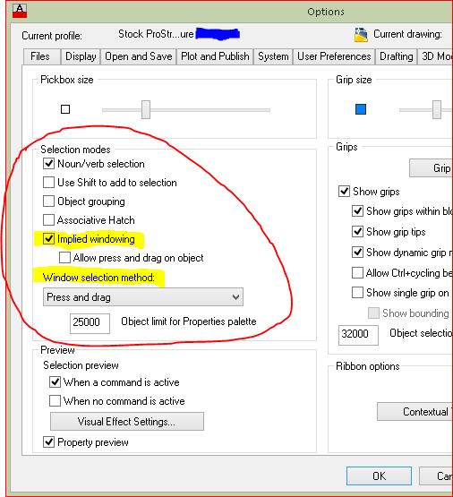

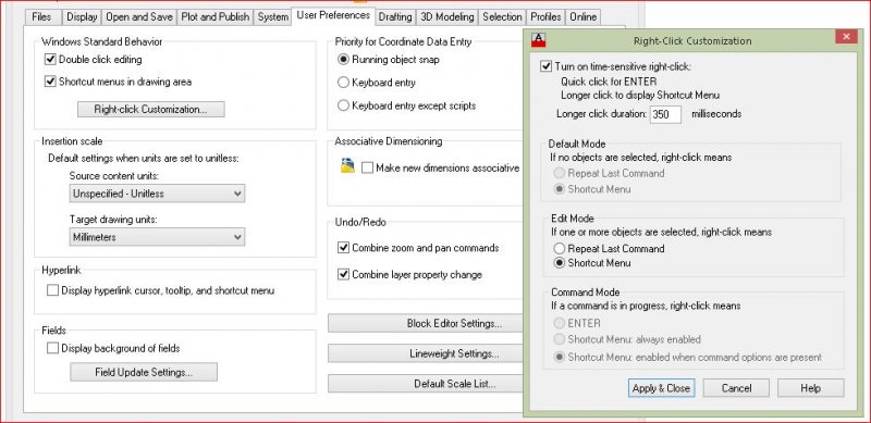

Dadgad Posted June 16, 2017 Posted June 16, 2017 (edited) Hey Remark. Yes i have actually tried several mouses. Some work better than ather but relating to my problem, no difference. It is as if acad is happy if i makle selections/ clicks with some small period in between, maybe a second or so. Maybe i just go to fast. I noticed that any mouse, only act when you release the button, not when you press it, so i make sure to release the button on the icon and not after i have moved away. But stil sometime i have to click it a second or third time. Today i actually swithced to my Caddie program out of frustration Take a look at your Selection Tab in OPTIONS. Including Allow Press and Drag on Object. Personally I like Implied Windowing, so I only need to click when defining the starting point of the crossing window. Or might this have to do with the setting of Time Sensitive Right Click on your User Preferences tab? Are you selecting with a crossing window? Edited June 16, 2017 by Dadgad Quote
jamos Posted June 16, 2017 Author Posted June 16, 2017 Take a look at your Selection Tab in OPTIONS. Including Allow Press and Drag on Object. Personally I like Implied Windowing, so I only need to click when defining the starting point of the crossing window.YES, I ALSO DO SELECTION LIKE YOU. SELECTING ON THE DRAWING SCREEN, I.E. FROM LEFT TO RIGHT (BLUE) OR FROM RIGHT TO LEFT ( GREEN) IS NOT AN ISSUE. MY PROBLEM IS WHEN I USE THE ICONS AT TOP, FOR INSTANCE, ROTATE, LINE, PLINE, OFFSET, ETC. IF I CLICK ON AN ICON AND MOVE AWAY TO PERFORM THE ACTION I NOTICE THE CLICK/ SELECTION DIDN'T HAPPEN, SO I HAVE TO DINIT AGAIN OR AGAIN. I HOPE I EXPLAINED IT SO THAT IT'S CLEAR Or might this have to do with the setting of Time Sensitive Right Click on your User Preferences tab?NO, RIGHT CLICK IS NOT AN PROBLEM . I HAVE SET AT THE STD OF250 MILISECONDS AND THAT IS JUST FINE Are you selecting with a crossing window? Quote
