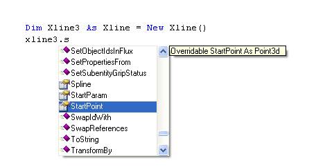

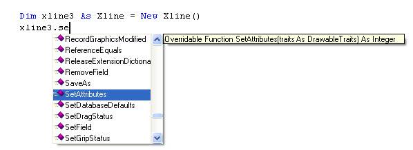

russell84 Posted January 14, 2009 Author Posted January 14, 2009 i don't know why its not working - but i can't add a "secondpoint" to the xline. Pic Attached. Im using these Imports [size=2][color=#0000ff]Imports [/color][/size][size=2]System [/size][size=2][color=#0000ff]Imports [/color][/size][size=2]System.Type [/size][size=2][color=#0000ff]Imports [/color][/size][size=2]System.CLSCompliantAttribute [/size][size=2][color=#0000ff]Imports [/color][/size][size=2]System.Reflection [/size][size=2][color=#0000ff]Imports [/color][/size][size=2]System.Runtime.InteropServices [/size][size=2][color=#0000ff]Imports [/color][/size][size=2]Microsoft.VisualBasic [/size][size=2][color=#0000ff]Imports [/color][/size][size=2]Autodesk.AutoCAD.Runtime [/size][size=2][color=#0000ff]Imports [/color][/size][size=2]Autodesk.AutoCAD.Geometry [/size][size=2][color=#0000ff]Imports [/color][/size][size=2]Autodesk.AutoCAD.ApplicationServices [/size][size=2][color=#0000ff]Imports [/color][/size][size=2]Autodesk.AutoCAD.EditorInput [/size][size=2][color=#0000ff]Imports [/color][/size][size=2]Autodesk.AutoCAD.DatabaseServices [/size][size=2][color=#0000ff]imports [/color][/size][size=2]Autodesk.AutoCAD.GraphicsInterface [/size][size=2][color=#0000ff]Imports [/color][/size][size=2]AcadApp = autodesk.AutoCAD.ApplicationServices.Application [/size] Also my Acad references are; acdbmgd.dll acmdg.dll Any ideas?? Quote
SEANT Posted January 14, 2009 Posted January 14, 2009 That is indeed odd. I suppose it's possible that Civil 3D does something different with the Xline implementation. Do you have a standard AutoCAD setup? Does the routine I posted above throw and error when run? Quote
