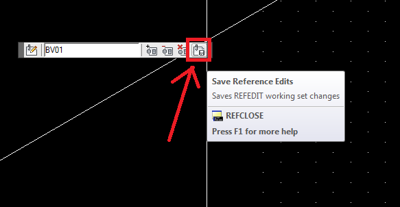

If you are talking about REFEDIT then you should see REFCLOSE. See attached image.
QDbcVsBLmCJBjiEOwvoKPIMcBT3F9A53G+A07jLgE5giQZ0Bjca4CzyDOgkbjfAKeQZ0HncdIAjuLUAV3DrATZjiQa4iLsPsA15BriOexAAEBykGgAgOEg1AEBwkGrb59lryMDa4s1RAWgPdzIAIDhINQBAcJBqAIDgINUAAMFBqgEAgoNUAwAEB6kGAAgOUg0AEBykGgAgOEg1AEBwkGoAgOAg1QAAwUGqAQCCg1QDAARHd6aaZ8+agbXLswMD4A4mBQBAcJBqAIDgINUAAMFBqgEAgoNUAwAEB6kGAAgOUg0AEBykGgAgOEg1AEBwkGoAgOAg1QAAwUGqAQCCg1QDAAQHqQYACA5Sbfs8ew0ZWFu8OSoA7eFOBgAEB6kGAAgOUg0AEBykGgAgOEg1AEBwkGoAgOAg1QAAwUGqAQCCg1QDAAQHqQYACA5SDQAQHKQaACA4SDUAQHB0Z6p59qwZWLs8OzAA7mBSAAAEB6kGAAgOUg0AEBykGgAgOEg1AEBwkGoAgOAg1QAAwUGqAQCCg1QDAAQHqQYACA5SDQAQHKQaACA4SDUAQHCQagCA4CDVts+z15CBtcWbowLQHu5kAEBwkGoAgOAg1QAAwUGqAQCCg1QDAAQHqQbY5f8DoweAuB4O0xkAAAAASUVORK5CYIIA
If you mean that you accidentally x'ed out of that little toolbar while REFEDITING, then type REFCLOSE . This should save and get out of REFEDIT. You can then proceed to run REFEDIT again to step back in and your toolbar should know be visible. Hope this helps.
