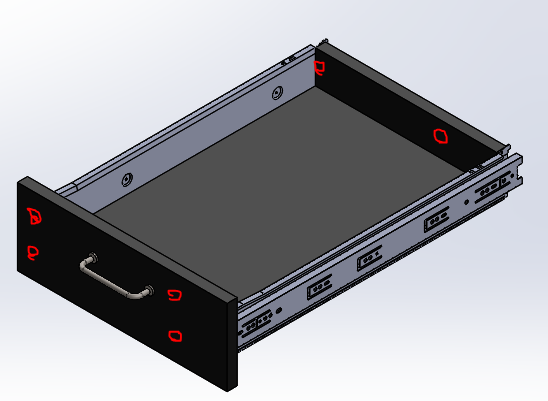

In this image the slides are fixed and this is where the holes would go if I added the smart feature.

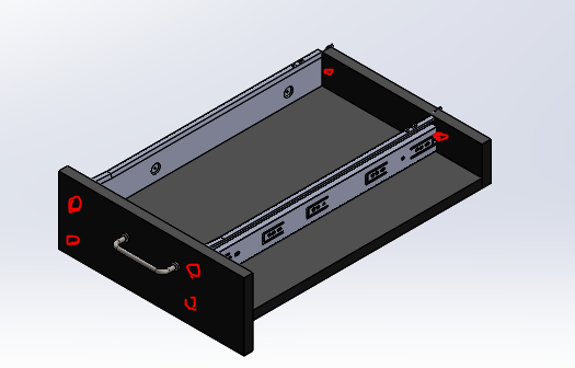

In this image, the slides are flexible, but when I add the smart feature the holes do not follow the slide that has moved. They are in the original position.
