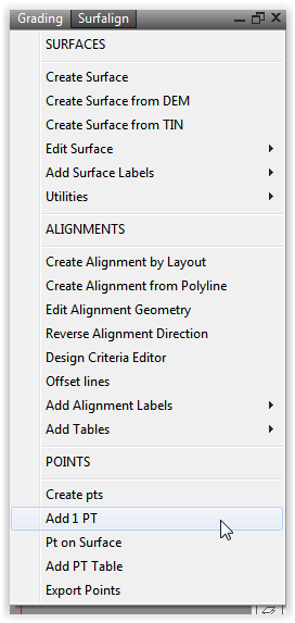

BIGAL Posted July 7, 2017 Posted July 7, 2017 YES You have to look at creating your own menus and set up a workspace, we run this now with everyone having their own workspace. As an example I run CIV3D but my workspace is set up as drafting but I have a couple of pull down menus where I have taken the CIV3d commands and grouped them into a menu. Quote

BIGAL Posted July 8, 2017 Posted July 8, 2017 I think you missed what Dadgad was suggesting you can open any toolbar in a workspace. I opened Modelling as a test using 2013. As a shortcut type "-toolbar Modeling Show" Here is the source for the Surfal.mnu its just a text file just do CUI and copy and paste the commands out into your menu. ***MENUGROUP=SURFAL ***POP15 **SURFALIGN [surfalign] [sURFACES] [--] [Create Surface]^c^c_AeccCreateSurface [Create Surface from DEM]^c^c_AeccCreateSurfaceGridFromDEM [Create Surface from TIN]^c^c_AeccCreateSurfaceFromTIN [->Edit Surface] [Edit Surface Style...]^c^c_AeccEditSurfaceStyle [Edit Surface Properties]^c^c_AeccEditSurfaceProperties [Add Line]^C^C_AeccAddSurfaceLine [Delete Line]^c^c_AeccDeleteSurfaceLine [swap Edge]^c^c_AeccEditSurfaceSwapEdge [Add Point]^c^c_AddPointToSurface [Delete Point]^c^c_AeccDeleteSurfacePoint [Modify Point]^c^c_AeccEditSurfacePoint [Move Point]^C^C_AeccMoveSurfacePoint [Minimize Flat Areas]^c^c_AeccMinimizeSurfaceFlatAreas [Raise/Lower Surface]^c^c_AeccRaiseLowerSurface [Paste Surface...]^c^c_AeccEditSurfacePaste [Add Boundaries]^c^c_AeccAddSurfaceBoundaries [smooth Surface]^c^c_AeccSmoothSurface [<-Simplify Surface]^c^c_AeccSimplifySurface [->Add Surface Labels]^c^c_AeccAddSurfaceLabels [Add slope Surf Labels]^c^c_AeccAddSurfaceSlopeLabel [spot Elevation]^c^c_AeccAddSurfaceSpotElevLabel [spot Elevations on Grid]^c^c_AeccAddSpotElevLabelsOnGrid [Contour - Single]^c^c_AeccAddContourLabelingSingle [Contour - Multiple]^c^c_AeccAddContourLabeling [Contour Multiple at Interval]^c^c_AeccAddContourLabelingGroup [<-Add legend table]^c^_AeccAddSurfaceLegendTable [->Utilities] [Export to DEM]^c^c_AeccSurfaceExportToDem [Volumes Dashboard]^C^C_AeccVolumesDashboard [Water Drop...]^c^c_AeccCreateSurfaceWaterDrop [Catchment Area]^c^c_AeccCatchmentArea [Check for Contour Problems]^c^c_AeccCheckForContourProblems [Drape Image]^c^c_AeccDrapeImage [Extract Objects From Surface]^c^c_AeccSurfaceExtractObjects [Move Blocks to Surface]^c^c_AeccMoveBlocksToSurface [Move Blocks to Attribute Elevation]^c^c_AeccMOVEBLOCKSTOATTRIBELEV [<-Move Text to Elevation]^c^c_AeccMoveTextToElevation [--] [ALIGNMENTS] [--] [Create Alignment by Layout]^c^c_AeccCreateAlignmentLayout [Create Alignment from Polyline]^c^c_AeccCreateAlignmentEntities [Edit Alignment Geometry]^C^C^p_AeccEditAlignment [Reverse Alignment Direction]^c^c_AeccReverseAlignDirection [Design Criteria Editor]^C^c_AeccDesignCriteriaEditor [Offset lines]^c^cOffsetfeature [->Add Alignment Labels]^c^c_AeccAddAlignLabels [Add/Edit Station Labels]^c^c_AeccEditAlignmentLabels [station/Offset]^c^c_AeccAddAlignOffXYLbl [single Segment]^c^c_AeccAddAlignSegLbl [Multiple Segment]^c^c_AeccAddAlignSegLbls [Point of Intersection]^c^c_AeccAddAlignPointOfIntLbl [<-Multiple Point of Intersection]^c^c_AeccAddAlignPointOfIntLbls [->Add Tables] [Add Line...]^c^c_AeccAddAlignmentLineTable [Add Curve...]^c^c_AeccAddAlignmentCurveTable [Add Spiral...]^c^c_AeccAddAlignmentSpiralTable [Add Segments]^c^c_AeccAddAlignmentSegmentTable [<-Renumber Tags]^c^c_AeccEditTagNumbers [--] [POINTS] [--] [Create pts]^c^c_AeccCreatePoints [Add 1 PT]^C^C_AeccCreatePointManual [Pt on Surface]^C^C_AeccCreatePointRandomPoints [Add PT Table]^C^C_AeccAddPointTable Quote

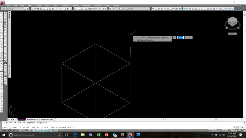

Neville Jukes Posted July 9, 2017 Author Posted July 9, 2017 I get all that & I can draw 3D models, however I can only draw 2D lines. See screenshot. Quote

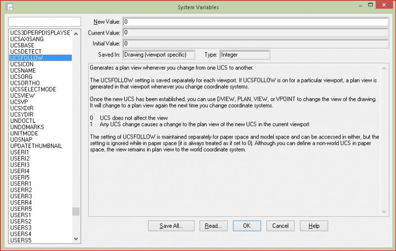

Dadgad Posted July 9, 2017 Posted July 9, 2017 I get all that & I can draw 3D models, however I can only draw 2D lines.See screenshot. Do you usually use Dynamic UCS? What is your UCSFOLLOW system variable set to? Might your OSNAPZ variable be set to ? If it is set to , try changing it to . What is your UCSDETECT variable setting? If it is 0 try switching it to 1. Are you saying that we are looking at a 3D Solid, or a 2D representation of one? Looks can be deceiving. Are you at liberty to upload the .dwg, that would really speed things up. Quote
steven-g Posted July 9, 2017 Posted July 9, 2017 From the clues in your screenshot, you where using the polyline command, I can only imagine it works the same way in full Autocad as LT, in that a pline can only ever be drawn parallel to the current UCS, the first point can be anywhere in 3D space you choose but after that it can only use the current X and Y plane (though you can pick 3D points any Z value is ignored - at least in LT). There is a 3dpolyline command which should work. Quote
Neville Jukes Posted July 9, 2017 Author Posted July 9, 2017 G'day Dadgad, Mate, My UCSFOLLOW is 0 My OSNAPZ is 0 My UCSDETECT is 1 And yes you are looking at a 3D solid but note the wording in the window asking for a 2D point! I just checked and it appears that I can draw a line in 3D but I can't draw a polyline (which I use all the time). Kind regards, Neville Quote

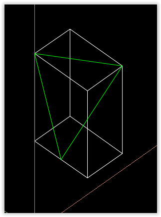

BIGAL Posted July 10, 2017 Posted July 10, 2017 3DPOLY is what you want Osnapz 0 look at green line Quote
Dadgad Posted July 10, 2017 Posted July 10, 2017 3DPOLY is what you want Osnapz 0 look at green line BINGO! 3DPOLY it is. Steven-g and BIGAL are right on the money. I don't think this has changed since 2010 or 2011 though? Quote
Cad64 Posted July 10, 2017 Posted July 10, 2017 It would help if we could see your command input history. Are you snapping to the corner of the box and then typing coordinates to set the endpoint of the line? If so, how are you entering the coordinates? Are you typing "@" followed by the X and Y values? If you type @12,12 or @12 Quote
Neville Jukes Posted July 10, 2017 Author Posted July 10, 2017 Thanks Guys, That's correct I just needed to add the 3DPOLY command button to my toolbar via customize instead of the standard polyline button. Thanks again for all your help. Kind regards, Neville Quote
