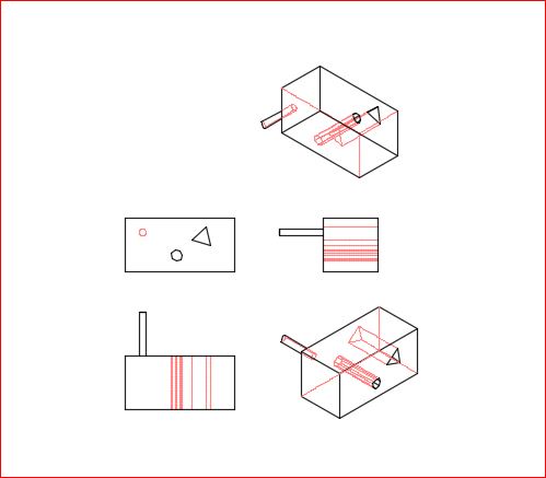

It has been a while since I used Viewbase, but I seem to recall that if you changed those layer names, that the next time you used it, those layer names would be used.
Untested, but that seems to ring a bell. Hope I am correct. :|
Or you could use the LAYTRANS command (with wildcards *) to do it, after the views had been generated.
I did a test, and it seems my recollection may have been erroneous.
What you can do in the Layer Manager after creating the views, select the viewbase layer names ending in Hidden, and in my case, I then right click and select merge selected layers to, and then I select Steel Hidden, as that is the layer I want them on.
Then I choose the Visible layer, and repeat that process, but choose the layer Steel, as that is the medium in which I am working, and the layer where I want them to display.
After you do that, they will look like a drawing you did yourself, with appropriate coloration.
LAYTRANS may be your best bet, for an in house solution.
