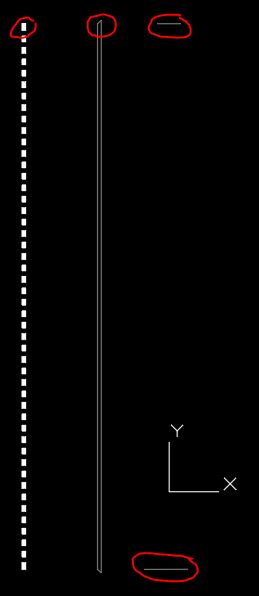

The problem seems to be that when running the TRIM command and selecting the 'breakline' from left to right on the bottom half it also selects objects that aren't completely within the selection.
I can't recreate the problem in a new drawing, so it must be some setting in the drawing file itself.

Actually, there are four polylines in model space. See.....
'Oh yeah, i deleted the fourth line at the top and all is well now :') '. Must be an old file :P, but there are only 3 that are in question here.

It must be a quirk in AutoCAD. I have just tried trimming in DraftSight, and it behaved as expected (only picked up the one cutting edge).
I wonder if it has anything to do with the short length of the bounding polyline at the lower end. I exploded the polyline, erased the two short lengths and remade the polyline without them (four lines only) and the trim worked as expected.
