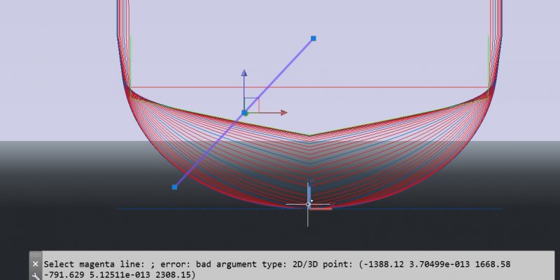

Hi Roy_04.
Have error when i selected the magenta line.
"Select magenta line: ; error: bad argument type: 2D/3D point: (-1388.12 3.70499e-013 1668.58 -791.629 5.12511e-013 2308.15)
How to solve this problem?
Thanks!
Kind Regards!
The line may only have a single intersection with each polyline.
Please check if the code works for the Frames_2.dwg and post your new dwg.

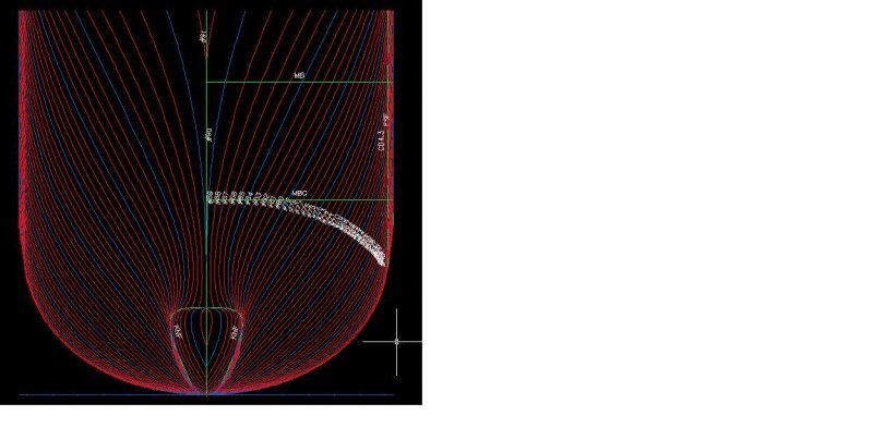

Code with Frames_2 is working. But when i try to work with the same situaltion, it's no worked.
I try to keep the Frames on x0y, and move along axis 0z, after that will rotate.
but also have error.
can you take alook to this drawing :)
Thanks!
Kind Regards!
Drawing3.dwg

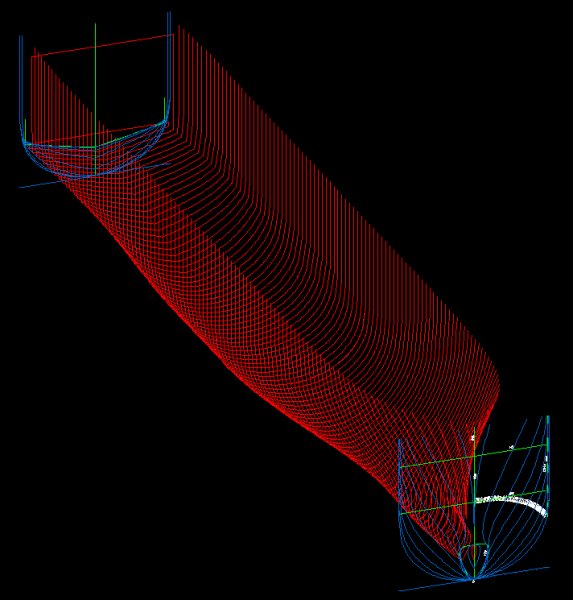

Your drawings are not consistent when it comes to the 3D alignment of the sections. But the new code will handle both your first and your last drawing.
In your last drawing there are two sections that are closed polylines. You have to pick the points of the temporary line more carefully to avoid intersecting them twice.
New code below.
The code will draw (and erase) the temporary line.
Only the red polylines are moved.
